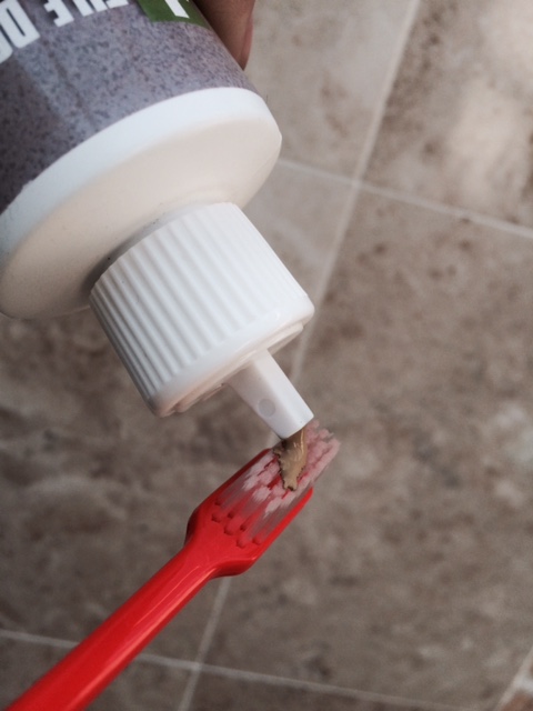

7.)If using Grout Colorant Applicator, pour Grout Colorant into Applicator bottle and apply a bead onto grout joint.Step 3 - Wipe off the exceess Grout Colourant.
8.)Spread evenly using the Applicator Brush or toothbrush, working Grout Colorant into joint using a back-and-forth motion. Thin, even coats should be applied, limiting the amount of Grout Colorant that gets on the tile.

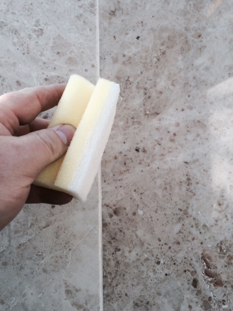

10.)After Grout Colorant has dried 1 or more hours (never more than 12 hours), lightly mist surface with water and let stand 5 minutes. Remove excess Grout Colorant from surface of tile using water and a white nylon scrub pad.Step 4 - Admire your handywork.
