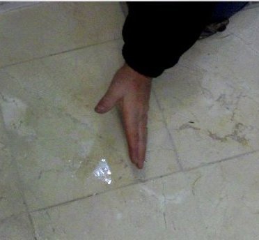

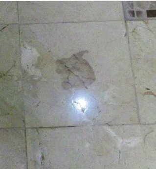

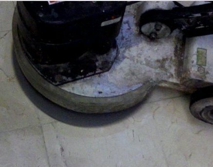

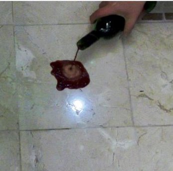

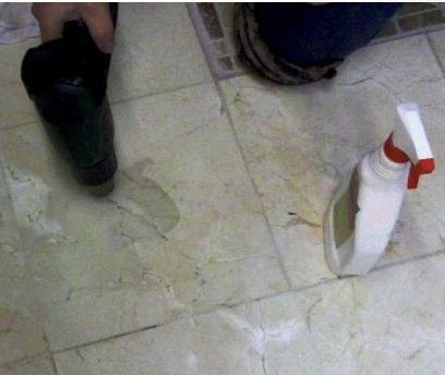

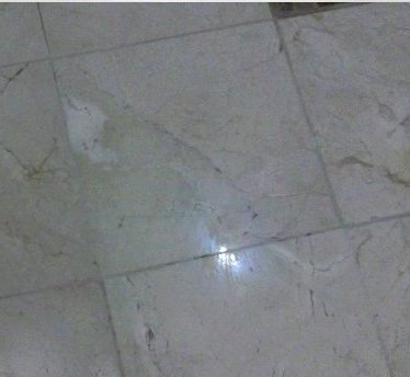

Oh Dear, someone spilt Echo Falls Red Wine on my Polished Crema Marfil Marble Floor Removed the Red Wine after 15 minutes but it left a stain Apply Tile Doctor Reduxa Stone Stain Remover and Heat, repeat up to 6 times Wine Stain Removed from Polished Crema Marfil Mable Floor Burnish and Polish the Floor to restore shine Good as new the Polished Marble floor restored and stain gone
