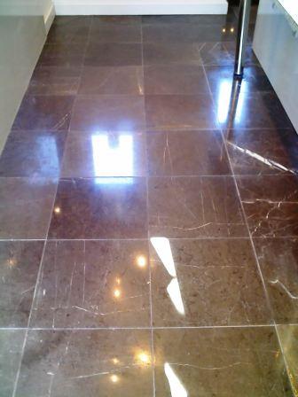

Rare black Honed Limestone after being cleaned and sealed by Tile Doctor Limestone Floor after Cleaining and Sealing Limestone Floor Limestone Worktop Limestone Tiles Limestone Tiles Limestone Flooring

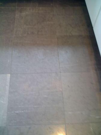

Limestone Floor before Cleaining and Sealing

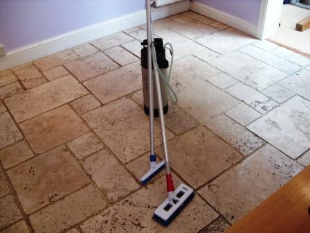

Limstone Tile Use Tile Doctor Pro-Clean Tile & Grout cleaner to effectively clean the stone tiles, highly effective against Wax Sealers, Grease, Grime and general dirt build up.
Limestone Tile For difficult floors mix Pro-Clean with Nanotech Ultra Clean for a double whammy cleaning solution. Nanotech-Ultra Clean incorporates Nano technology to help lift the dirt from the tiles (it really works), especially useful for those hard to clean floors where the dirt has ingrained itself over many years.  Use a wet-dry vac machine to remove the dirty solution.
Limestone Tile Neutralise the stone floor with clean water and leave to dry for 30 minutes or more.
Limstone Tile Apply Tile Doctor Pro-Seal premium sealer using a clean dry terry cloth (not the fluffy variety). Rub Sealant into the tile. Allow to dry before applying a second coat. Use a water test to achieve full cure sealability (F.C.S.). Limestone Floor after Cleaining and Sealing

Rare black Honed Limestone floor before cleaning and sealing       The same rare black Honed Limestone after being cleaned and sealed by Tile Doctor
A rare black Honed Limestone floor restored by Tile Doctor
