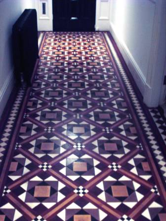

Hallway restored to its former glory by the Kent Tile Doctor
Victorian Tile before being cleaned by Kent Tile Doctor
Tiles before Cleaning & Sealing
Victorian Tile after being cleaned by Kent Tile Doctor
Tiles after Cleaning & Sealing

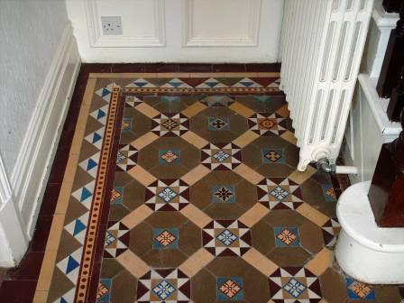

Hand Painted Victorian Tile To remove any excess sealer before cleaning use Tile Doctor Remove & Go Sealer remover.
Hand Painted Victorian Tile Use Tile Doctor Pro-Clean Tile & Grout cleaner to effectively clean tiles, highly effective against Wax Sealers, Grease, Grime and general dirt build up.
Hand Painted Victorian Tile For difficult floors mix Pro-Clean with Nanotech Ultra Clean for a double whammy cleaning solution. Nanotech-Ultra Clean incorporates Nano technology to help lift the dirt from the tiles (it really works), especially useful for those hard to clean floors where the dirt has ingrained itself over many years.
Hand Painted Victorian Tile Remove any cleaning solution using a wet-dry vac machine (any cleaning solution left on the surface may impact the performance of the sealer) then neutralise floor with clean water prior to sealing, remove with a wet-dry Vac machine and allow to dry for 12 hours or more.
Hand Painted Victorian Tile For a low sheen finish apply Tile Doctor Seal & Go sealer using a paintpad applicator and tray. 4 to 5 coats of sealant may be required, always allow to dry before applying furhter coats. Use a water test to achieve full cure sealability (F.C.S.).

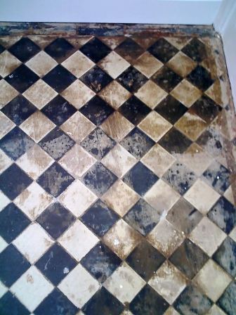

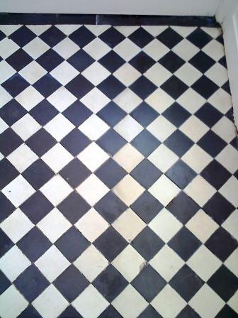

I am attempting to clean an exterior Victorian chequerboard style tile pathway. Can I use an acid based cleaner for this purpose as the tiles are rather discoloured, especially the white ones.
Tile Doctor Hi David,
Thanks for the e-mail, however please don't use Acid cleaners for any tiles as they will only damage them, try an alkaline cleaner instead, we have one called Pro-Clean Tile And Grout Cleaner, if it is outside you may be able to use a power sprayer as well, and that should give you a good result. Ps... We sell a sealer called Seal and Go, it works outside and inside.

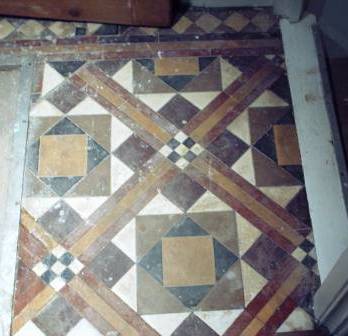

A Victorian Floor in Cheshire Restored by Tile Doctor A Victorian Floor in Cheshire Restored by Tile Doctor
Floor in Cheshire hidden under Carpet for 25 Years and restored by Tile Doctor
Victorian Tile before being cleaned by Tile Doctor Victorian Tile after being cleaned by Tile Doctor
