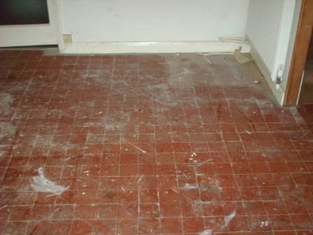

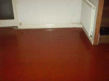

Click to Enlarge - Quarry Tile Floor Before Cleaning and Sealing Click to Enlarge - Quarry Tile Floor After Cleaning and Sealing

A classic hard wearing tile often utilised in high traffic areas such as reception areas and also often used for outdoor patio areas and porches. Although hard wearing Quarry tiles are often neglected and hidden under years of grime, however all is not lost they can be restored, see below for details.
Before Picture - A Quarry Tile Floor Restored by Tile Doctor After Picture - A Quarry Tile Floor Restored by Tile Doctor
A Quarry Tile Floor restored by Tile Doctor

Quarry Tile To remove any excess sealer before cleaning use Tile Doctor Remove & Go Sealer remover.
Quarry Tile Use Tile Doctor Pro-Clean Tile & Grout cleaner to effectively clean tiles, highly effective against Wax Sealers, Grease, Grime and general dirt build up.
Hand Painted Victorian Tile For difficult floors mix Pro-Clean with Nanotech Ultra Clean for a double whammy cleaning solution. Nanotech-Ultra Clean incorporates Nano technology to help lift the dirt from the tiles (it really works), especially useful for those hard to clean floors where the dirt has ingrained itself over many years.
Quarry Tile Always neutralise floor with clean water prior to sealing, mop up and allow to dry for 30 minutes or more.
Quarry Tile For a low sheen finish apply Tile Doctor Seal & Go sealer using a paintpad applicator and tray. 4 to 5 coats of sealant may be required, always allow to dry before applying furhter coats. Use a water test to achieve full cure sealability (F.C.S.).
Quarry Tile Alternatively for extra shine use Tile Doctor High Shine sealer using a paintpad applicator and tray. Slate tiles may require up to 2 or 3 coats, always allow to dry before applying the next coat. Use a water test to achieve full cure sealability (F.C.S.)
