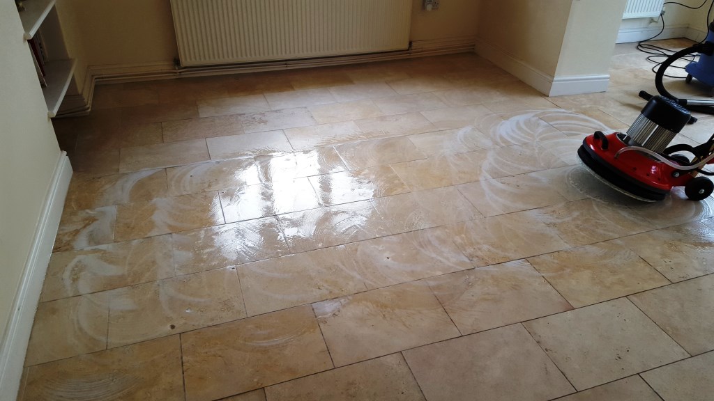

Limestone Tile If you have the use of a 150 RPM (or slightly higher) buffing machine restore the honed finish by burnishing the floor using a No.1 Red burishing pad to take off the old sealer and ground in dirt, add water to the area and then go over each tile with the pad 3 or 4 times, then remove the dirty water using a wet vax and rinse the floor. Next take off the coarse pad and apply a No2 Blue burnishing pad and repeat the process followed by the No.3 Yellow burnishing pad.  Again remove the water with a wet Vax machine and then scrub the grout joints with Pro-Clean diluted 1:5 parts water. Leave to fully dry and then complete by applying a No. 4 Green burnishing pad and polish with a squirt of water. When fully polished protect the floor by applying a sealer as per instructions below.
Polishing a Limestone Floor is South Wales
Limstone Tile Alternatively spray undiluted Tile Doctor Remove and Go onto the stone (use as directed), leave to dwell for ten to fifteen minutes (if necessary add more product to prevent it drying out) then agitate with a scrub brush or a black buffing pad fitted to a buffing machine.  Add water as you go to lubricate the process and then use a wet Vax to extract the soiled solution from the floor.  Rinse thoroughly with clean water to make sure the floor is neutralised of any chemicals. In normal circumstances allow 24 hours for the stone to dry out before sealing, a damp meter can be used to verify when the stone is dry.
