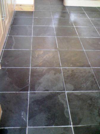

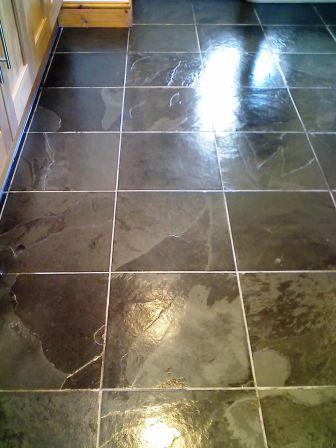

Picture shows slate before cleaning and sealing Picture shows how the sealer has brought out the colour in the slate.
Picture shows how cleaning and sealing has brought out the colour and beauty of this rough Slate floor.

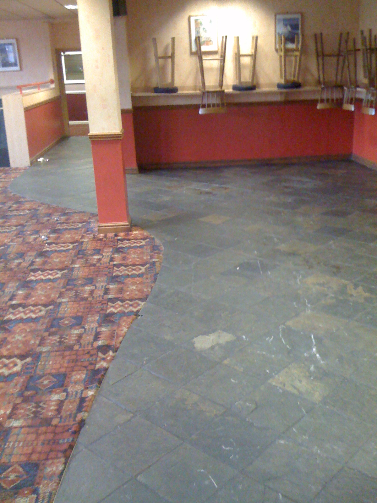

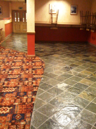

Slate Floor in a workings mens club in desperate need of a clean and seal Slate Floor restored by Tile Doctor
