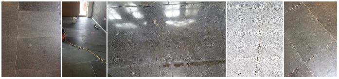

Basalt stone is an Igneous Volcanic rock, found in lava flow after a volcano erupts. Once cooled down it makes for an excellent hard stone, if somewhat pitted. As such Basalt has become a popular choice for hard floors. Generally Basalt is easier to maintain than Granite, which can be very expensive to re-polish due to its hardness, Basalt as a rule can be maintained quite easily using a set of Diamond pads.
Floor Tile Cleaning
Basalt TileIf you have the use of a 150 RPM (or slightly higher) buffing machine restore the honed finish by burnishing with a set of diamond burnishing pads. These pads remove old sealers and ground in dirt and restore the polished appearance. Click here for instructions and ordering.
When fully polished protect the stone by applying a sealer as per instructions below.
Set of Diamong Stone Burnishing Pads Please Note we also sell coarser 50, 100 and 200-grit Milling Pads in 6 and 17 inch sizes to be used where the stone requires a much deeper clean.
Basalt Tile Alternatively spray undiluted Tile Doctor Remove and Go onto the stone (use as directed), leave to dwell for ten to fifteen minutes (if necessary add more product to prevent it drying out) then agitate with a scrub brush or a black buffing pad fitted to a buffing machine.  Add water as you go to lubricate the process and then use a wet Vax to extract the soiled solution from the floor.  Rinse thoroughly with clean water to make sure the floor is neutralised of any chemicals. In normal circumstances allow 24 hours for the stone to dry out before sealing, a damp meter can be used to verify when the stone is dry.
