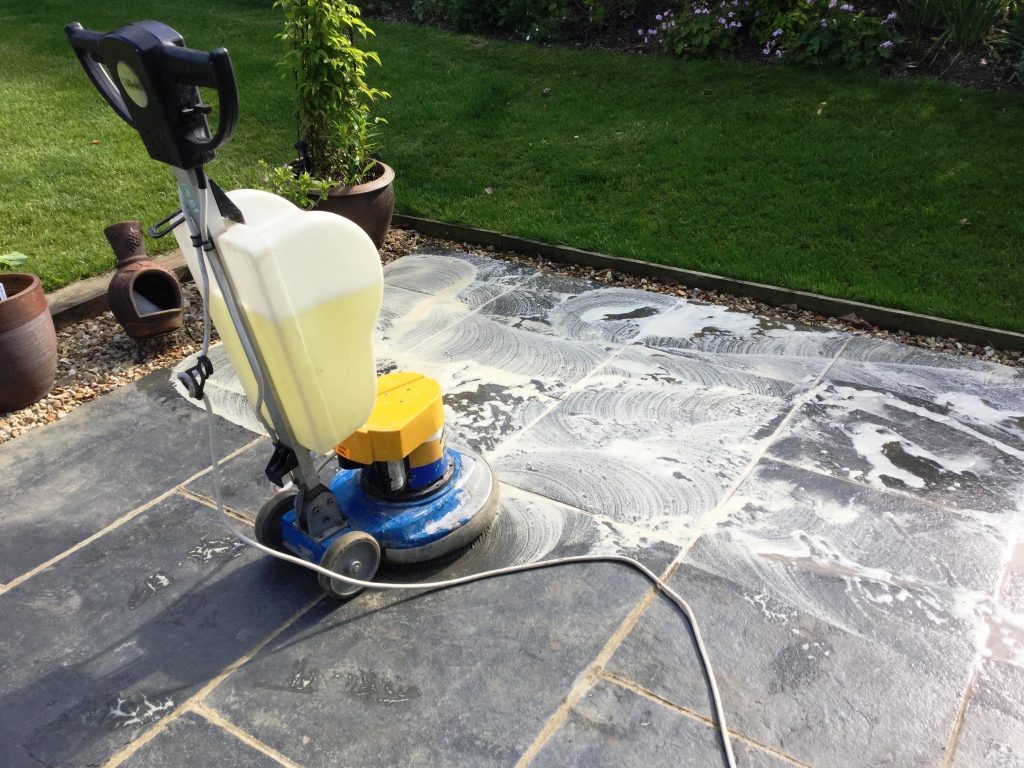

Limestone Tile Apply Tile Doctor Pro-Clean diluted 1:3 with water and leave to dwell for ten mintutes. Then scrub the Pro-Clean into the stone with a Black buffing pad fitted to a rotary floor machine. Remove the resulting slurry with a wet vacuum and rinse down the stone with water a few times to remove and remaining solution. Leave to dry off overnight.
Black Limestone patio during cleaning in Walgrave

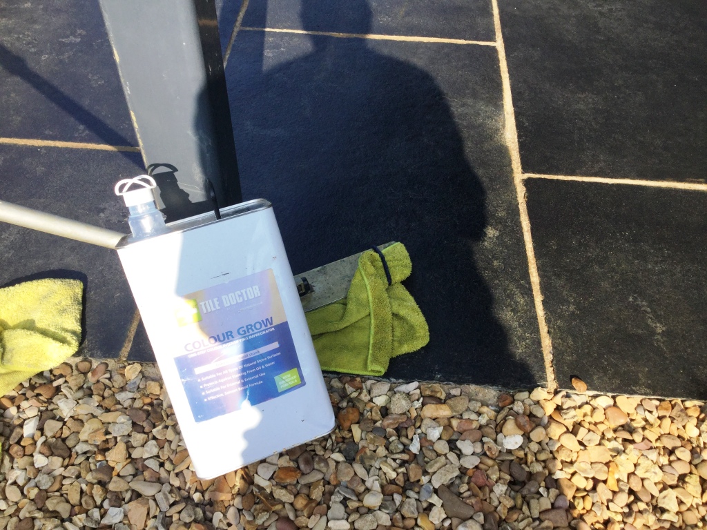

Limestone Tile A sealer should only be applied when the stone is fully dry so you may need to wait until the weather improves before applying a sealer. If your unsure use a damp meter to measure the mositure level in the stone. To seal apply one coat of Tile Doctor Colour Grow, its a penetrating colour enhancing that will protect the stone, intensify the black colour and is rated for external use.

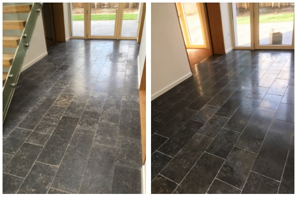

For internal Wall & Floor Tile Maintenance including cleaning, polishing and sealing please treat in the same way as normal Limestone. Full details on the maintenance of Limestone can be found on our Limestone maintenance page.
Black Limestone floor in Godalming cleaned and sealed
