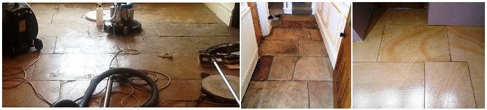

Rough Sandstone Floor in Bamber Bridge Flagstone Floor in Carnforth

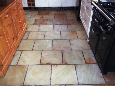

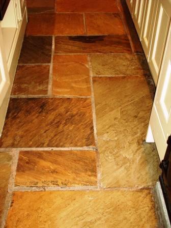

Picture shows Indian Sandstone kitchen floor before cleaning and sealing Picture shows how the sealer has brought out the colour in this Indian Sandstone kitchen floor.
This picture shows how Tile Doctor has managed to clean the dark patches from this Sandstone floor.

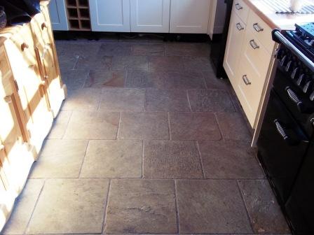

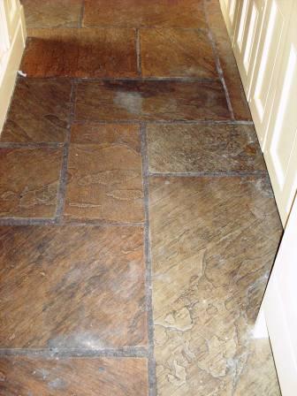

Picture shows Sandstone kitchen floor before cleaning and sealing Picture shows how the sealer has brought out the colour in this Sandstone kitchen floor.
Picture shows how cleaning and sealing has brought out the colour and beauty of the Sandstone.
