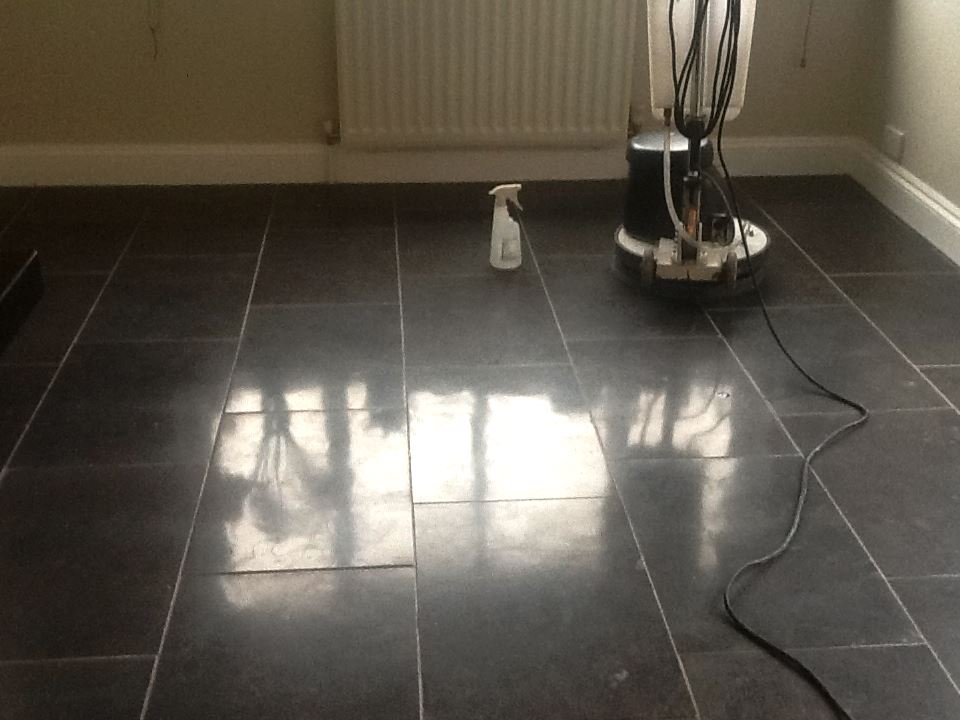

Polishing a Marble Floor in Northampton
 Alternatively spray undiluted Tile Doctor Remove and Go onto the stone (use as directed), leave to dwell for ten to fifteen minutes (if necessary add more product to prevent it drying out) then agitate with a scrub brush or a black buffing pad fitted to a buffing machine. Add water as you go to lubricate the process and then use a wet Vax to extract the soiled solution from the floor.  Rinse thoroughly with clean water to make sure the floor is neutralised of any chemicals. In normal circumstances allow 24 hours for the stone to dry out before sealing, a damp meter can be used to verify when the stone is dry.
