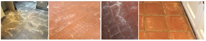

Efflorescence refers to the white patches you often see on brickwork and tiles. It's caused by salts being deposited on the surface as moisture evaporates. We find this problem is quite common on older floors that do not have a Damp-Proof Membrane (DPM) installed. Without this barrier in place, damp in the substrate rises through the tile taking with it salts from the ground. In extreme cases where moisture is trapped under the floor by an non-breathable sealer or other covering it can cause damp to spread to the walls leading to rising damp.
Floors installed before the mid 1960s rarely had a DPM and this is especially true of Victorian tiled floors which were typically laid on a wet screed over mud, clay, sand, chalk and often in the case of terraced buildings the rubble from adjacent building works.
The appearance of efflorescence is more common as we move into Winter and the central heating gets switched back on. Its also quite common in Kitchens where range cookers such as Aga's have been installed which provide a constant warm environment that encourages evaporation.
